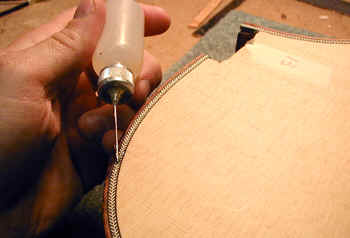

Hey guys, I need to drop fill some pores...(I know, it's the LAST one I have to finish...they're all headed to Tony from here on out!)...found this on Charlie Hoffman's site and would like to get one or two...I thought I saw something similar in SMac's book, but not anymore...anyone know where I can find one? TIA.
PostPosted: Tue Apr 11, 2006 12:54 am
My local plastics store has something pretty similat to that. They sell them for gluing lexan or plexi together, along with weldon cement. You can buy the applicator separate though.
PostPosted: Tue Apr 11, 2006 12:58 am
Larry, I got one at my plastics place too. But be warned, unless you want to do a lot of cleaning with acetone, it's going to clog very fast. I'd look into disposable pipettes first.

PostPosted: Tue Apr 11, 2006 1:04 am
I am with Paul here these have become unpopular because of the regular cleaning and needle replacement required. They are used well for lubricants but not so well for glues CAs, or finishes. Disposable pipettes have pretty much replaced them in these usages.
PostPosted: Tue Apr 11, 2006 1:07 am
Okay, that's a good point guys...I have some SMac pipettes from a while back, but was looking for something a little more betterer...but, since this is the last time I plan to do this... ...Thanks for the help!

PostPosted: Tue Apr 11, 2006 2:36 am
Here is a FF tip. Take your pipette, pull the tip and stretch the pipette. The pipette will get long and skinny. trim it and you have a micro-pipette tip.
PostPosted: Tue Apr 11, 2006 2:56 am
Ah, Bruce! You are indeed the "Yoda" of pipettes!      Thanks!

LMI has "pro tips" that fit right on the CA glue bottle.
No transferring to a pipette or other bottle that way.

I buy micro capillary tip extensions that fit on 2 oz CA bottle nozzels from our local RC hobby shop at 20 for $2 then stretch them even a bit more so thin CA will just barley let a drop out with out squeezing the bottle. there so cheap and darn near spill proof.
